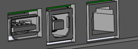

I have a model containing 2 parts;
1) A PCB with RJ45 & USB connectors on it.
2) A housing containing the PCB.
I would like to cut-out a series of squares in the housing so that the connectors protrude from it slightly.
I have drawn a new sketch in the assembly and projected the geometry using 'Convert Entities', I then allowed a small offset for clearance purposes and used the Cut-Extrude command to cut out a rectangle from the housing.  This is great, but the change has obviously been done to the assembly and not the housing, can anyone help me to do the same, but in the housing part drawing.
Many Thanks
John
SolidworksAssemblies
Answers 5
GS
GS 2013-11-19 Best Answer
Welcome to the forum.  In your assembly, right-click on the assembly cut in the tree and choose the "Edit feature" icon.  Check the box marked below.  That will make the cut carry over to the part file and show in any drawings using this part.

Method #2, before you make the sketch for the cuts, right click on your housing, and select 'edit part'.  This will put you in part mode, while in the assembly.  Works if you are allowing in-context relationships to parts from assemblies.

Apologies for the delay in replying, it worked great.
