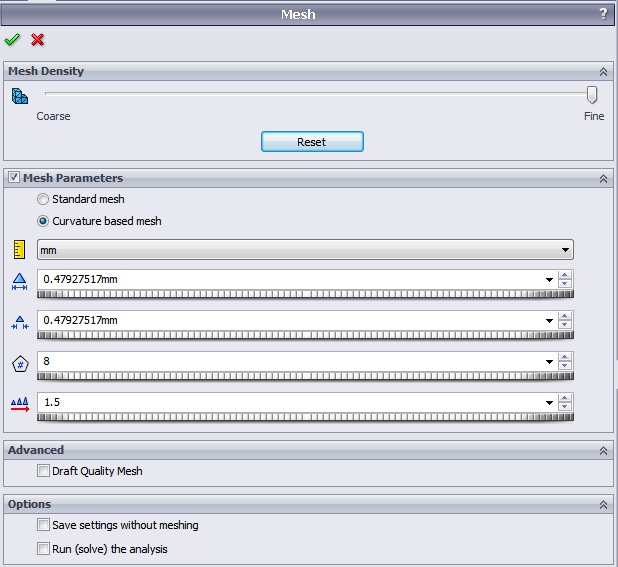

                   I need to know convergence in 2D simplification study.  To get convergence of results,
do I need to move the slider to the rightmost end in the mesh and curvature based as well? That is,
  If the slider is at the rightmost end with curvature based mesh and the elements size shows for example 0.479….
At that time I need to stop or can I go beyond the settings by manually like giving 0.3,0.1,0.01.. to get convergence.
              can anyone suggest me at this condition? Thank you

moving the slider to the right refines the mesh, so yes this is the general method for mesh convergence.
also, most would use mesh controls in addition to the global mesh.

Yes Jared you are right and thank you for the reply. I found the opiton ( Adaptive mesh )  in the study but I can't found the same option in 2D simplification study thatswhy I asked, do we need to use slider to the right or meshing it with manual settings for better results. And the info in the link is much useful one.

have you checked the solidworks knowledgebase? i don't think that adaptive is available for 2d simplification problems. you need to use the manual method by controlling the global and the mesh controls. "finer" provides more elements which captures the stress better potentially.
