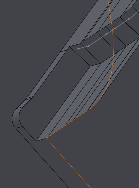

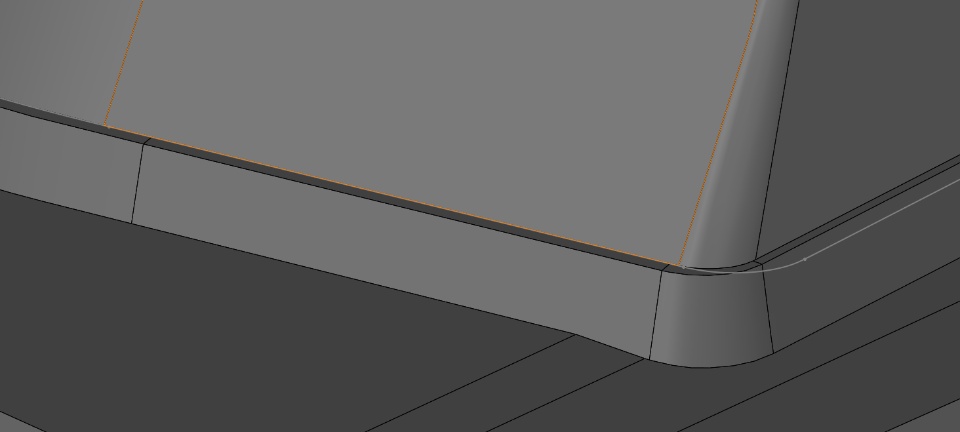

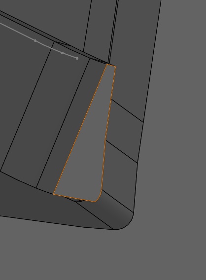

I need help ton control a sweep feature,:
I have a mold with not regular (complex) 3D geometry. On the edge I need to add an overthickness following the mold surface. I created a 3dsketch for the path. When the sweep geometry turn around the mold edge it rotates and I loose the sweep feature orientatio(i need the overthickness to be very regular).
but:
1. I cannot control rotation because it is not a "regular trajectory".
2. It is difficult to create a guide curve since nothing isd flat or regular.
Do i use the wrong technique? how would you proceed.
Thank you
fig.1 the mold edge where the sweep rotate
fig.2 cross section at begining
fig. 3 cross section at the end

Dear all,
Yes the part is proprietary. But I've worked on that the whole week-end and indeed the only way to go if you want to guaranty tight tolerances (on curved 3d geom.)  is to work with offset surfaces you use either as surface boundary for boss/extr or boundary surface extr.
No way you can fully control a sweep or loft with tight complex geom, it is too unstable.
By the way, when you check on internet about loft and sweep, these features seem to be only suitable for new age flower pot
I thank you for your help!

Could this feature be added using simple planar boss extrude, extrude cut, extrude up to surface type means? Then once it's there use a parting line draft to maintain the edges you want but to place the draft onto the required faces?
Could you sweep a surface, which extends beyond your target area a little bit, then use this as an end condition for a boss feature. Or make this boss not merged, work it 'till it's right, then combine when it's good.
