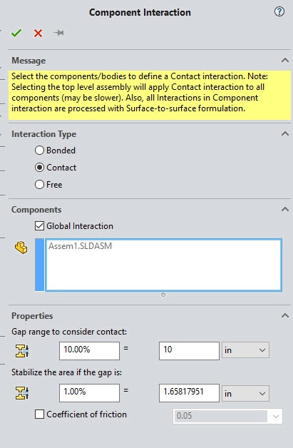

Hi, I'm using the new updates of Solidworks 2021 Simulation. I wanna ask about the Contact interaction type properties. I wanna know what values to enter on "Gap range to consider contact" and "Stabilize the area if the gap is" in relation to no gap(contact parts) and minimum gap of assembly . What are these parameters do to improve simulation result?

Typically, you would keep these at the default settings for your first run of a study (perhaps using draft quality mesh for faster initial solve), and then make adjustments if needed.
Here are good places to start regarding the new 'Gap range to consider contact' and 'Stabilize the area if the gap is' portions of this dialog:
- http://help.solidworks.com/2021/english/whatsnew/c_wn2021_simulation_robust_default.htm
- http://help.solidworks.com/2021/English/WhatsNew/c_wn2021_simulation_contact_stabilization.htm
- https://blogs.solidworks.com/solidworksblog/2020/10/solidworks-simulation-2021-enhanced-contact-for-faster-more-stable-and-accurate-results.html
