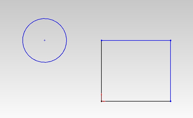

Hello,
I have two machines in a teaching lab that are exhibiting unique line styling when in Edit Sketch mode.  Both machines produce a solid line when the "For Construction" box is ticked, and the standard lines appear a bit thicker than most default installs.  Here's a photo - both the circle and the rectangle are marked for construction.
I've looked at the Line Format menu, but I'm not sure how that would apply.  I have moved a part template from a machine that displays properly to one of the suspect machines and find that the problem persists, even when I use the transfered part template.  To me, that would rule out a "Document Options" issue.
I've also scoured the System and Document options and find nothing pertaining to line styling in there (except for the options for leader lines on drawings).
Anyone run across this before?

It could be an issue of the line format, but there is an easy way to check that.
Click on the line, then convert it to not for construction, then back to for construction. Is it now a dotted centerline?
If that doesn't work, check the file C:\...\solidworks\lang\english\Swlines.lin
This file controls the line shapes, make sure it is the same on both the working systems and the non-working systems.

I replaced the Swlines.lin file on one of the troublesome machines with the same file from a working machine with no success.
Also, toggleing the "For construction" tick box multiple times has no effect.
The only distinction between a construction line and a "regular" line on these machines seems to be a slight variation in weight.  The are still both solid lines.

Is it perhaps your graphics card? Try using the "Use software OpenGL" option in System Option->Performance. Remember, to toggle this option you cannot have any solidworks files open. If you see the dashed construction lines with software OpenGL active then it is a problem with your graphics card. You will then have to investigate settings and drivers for your card.
PB
PB 2012-03-19
Thanks Peter - you nailed it.
