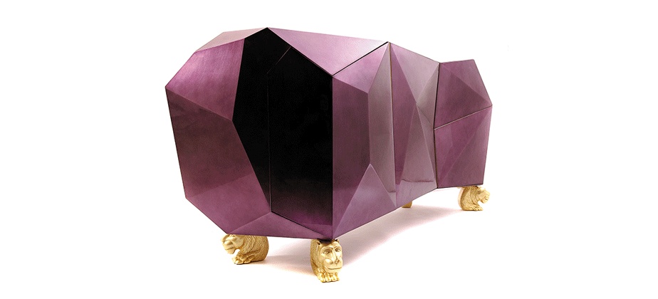

Hi all,
Im new to solidworks and i have some questions for you guys. Im trying to make a 3D irregular solid as the same type as the one in the picture bellow. I want to be able to create an original solid with faces as i see fit. I want to kown what's the best way to make this type of solid considering  that i will experiment on the patterns. After finishing, is it possible to dismount all the pieces from the solid to set measures and see all the angles between faces, and if so, how can i see that. At last can u guys tell me how can i create thickness in the solid.

Miguel,
This is not something for a beginner. You might want to read up on 3d sketching and surfaces to construct this.
Use the 3d sketch to create the hard lines of the facets and then apply surfaces accross the edges.
this would be how i would start... omay have other ways... but each way teaches you better modeling.
JR
JR 2013-09-22
If all of those faces are flat and you plan to keep them flat throughout your design process then I would think you could create a master 3D sketch (or a few 3D sketches to keep it a little less crowded or busy whilst editing the sketch) which would be referenced by other planes and sketches. The 3D sketch would have lines where you see any edge in your picture. You could make a few solid bodies and cut them but just making planar surfaces, knitting, thicken would be the more effecient option than starting off with solids.
To see the angles and sizes, you can use the measure tool after the item is designed. Or using the surface approach you can measure each surface body before you knit the surfaces together.
