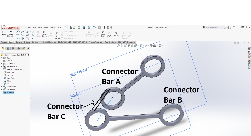

Hi all.
Is there a suggested best practice to connect two surfaces with another bar like the one stated below?  I'd like to create Bar C connecting Right plane object with the Plane 1 object and I'd like the bar to look like Connector Bar A(Connecting two circle object).  Not sure whether I make any sense with the question.  Any suggestions?

, it's pretty straight forward ...
If you look at ' screen shot you'll see that he used a "Loft" with two sketches. One sketch on each face located where you need them to be and using the "Loft" feature to extrude the boss from there. The "Loft" feature is simply going to connect the two sketches together and should turn your two separate solid bodies into one solid body.

Marek.  That's exactly what I have in mind.  Mind sharing with me how you did it?  Actually, better yet, if you could show me how to do it with the middle line connected those 2 dots as a guideline, that'll even be more awesome.  Thank you..

You want a third "link" in a chain which looks like the other two, as I understand it.
Don't model this object as a part, make it as an assembly containing three of the same Connector Bar parts.
Is there some reason this multibody thing is considered a part? It is to be purchased or fabricated?

Hi Dude,
did you mean something like this??
comment imagecomment image

to be honest, i do not understand, what the problem is...
You've created successfully two connectors, so a third should not be the problem?!
But maybe - a depending on your goal you are trying to achieve - it's better to build up an assembly. For me it looks like you want to have three individual parts and maybe with some movement.. And this couldn't be done in a multi-body part.
