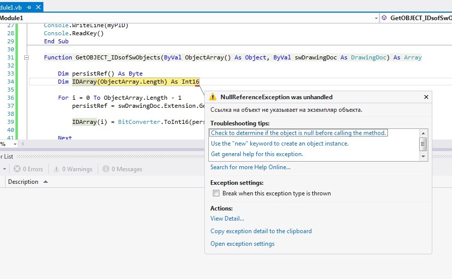

Thank you for  reply, but i have a error.
Sub Main()
    Dim myNote As Note
    Dim pID As Object
    Dim myPID As Object
    swApp = CreateObject("SldWorks.Application")
    Part = swApp.ActiveDoc
    selMgr = Part.SelectionManager
    myNote = selMgr.GetSelectedObject6(1, -1)
    pID = Part.Extension.GetPersistReference3(myNote)
    myPID = GetOBJECT_IDsofSwObjects(Items, DrawingDoc)
    Console.WriteLine(myPID)
    Console.ReadKey()
    End Sub

Can you check how many items you have in the ObjectArray before code line 34 is executed?
SF
SF 2014-01-14
Dim persistRef() As Byte
        Dim IDArray(ObjectArray.Length) As Int16
        For i = 0 To ObjectArray.Length - 1
            persistRef = swDrawingDoc.Extension.GetPersistReference3(ObjectArray(i))
            IDArray(i) = BitConverter.ToInt16(persistRef, persistRef.Length - 8)
        Next
        Return IDArray
SF

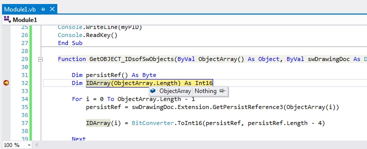

SF 2014-01-14
Set a breakpoint at "Dim persistRef() as Byte" and tell me how many items you have in ObjectArray
SF
SF 2014-01-14
ObjectArray: Nothing
SF
SF 2014-01-14
You have to pass your selected optects when you call the Function "GetOBJECT_IDsofSwObjects"
Can you show me some codelines where you call the Function?

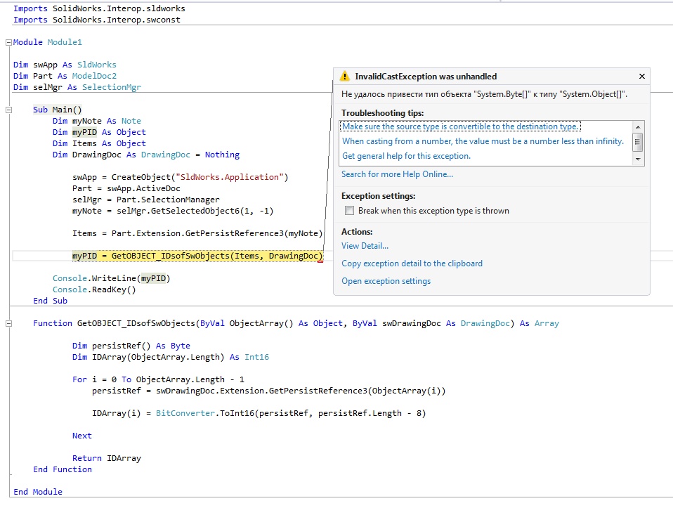

SF 2014-01-14
Dim Items As Object
Dim DrawingDoc As DrawingDoc
SF
SF 2014-01-14
And where do you set the Items and the DrawingDoc Variables?
you can't only past the empty variables to the function.
You have to get first the selected items with the selectionmanager from solidworks and the drawing document.

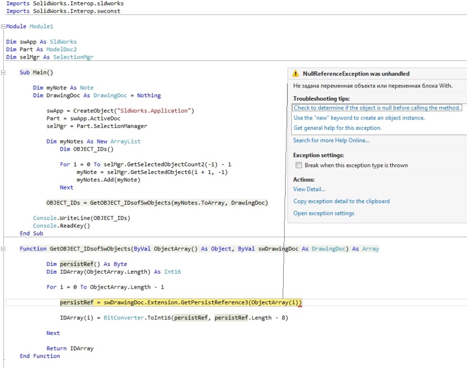

SF 2014-01-14
Yeah, sry) you are right, but now i have new error)
SF
SF 2014-01-14
You have to past the notes.
Do something like this:
Dim myNotes as new Arraylist
Dim OBJECT_IDs()
For i = 0 to selMgr.GetSelectedObjectCount2(-1) - 1
     myNote = selMgr.GetSelectedObject6(i+1, -1)
     myNotes.add(myNote)
Next
OBJECT_IDs = GetOBJECT_IDsofSwObjects(myNotes.toArray, swDrawingDoc)
SF
SF 2014-01-14
New error)
SF
SF 2014-01-14
Did you select some notes in solidworks?

Yea Georg, i select notes. Guys, maybe i do something wrong, It doesn t work.  Can you look at my project ? Thanks in advance!
SF
SF 2014-01-14
Try this....
<p>Sub Main()</p><p></p><p>        Dim myNote As Note<br>        Dim drawingDoc As DrawingDoc</p><p>        Dim swDoc as ModelDoc2</p><p></p><p>            swApp = CreateObject("SldWorks.Application")</p><p>            swDoc = swApp.ActiveDoc<br>            drawingDoc = swDoc<br>            selMgr = swDoc.SelectionManager<br>            myNote = selMgr.GetSelectedObject6(1, -1)</p><p></p><p>            Dim myNotes As New ArrayList<br>            Dim OBJECT_IDs()</p><p></p><p>            For i = 0 To selMgr.GetSelectedObjectCount2(-1) - 1<br>                 myNote = selMgr.GetSelectedObject6(i + 1, -1)<br>                 myNotes.Add(myNote)<br>            Next</p><p></p><p>            <br>            OBJECT_IDs = GetOBJECT_IDsofSwObjects(myNotes.ToArray, drawingDoc)</p><p></p><p>            Console.WriteLine(OBJECT_IDs)<br>            Console.ReadKey()<br>            End Sub</p><p></p><p><br>    Function GetOBJECT_IDsofSwObjects(ByVal ObjectArray() As Object, ByVal swDrawingDoc As DrawingDoc) As Array</p><p></p><p>            Dim persistRef() As Byte<br>            Dim IDArray(ObjectArray.Length) As Int16</p><p></p><p>            For i = 0 To ObjectArray.Length - 1</p><p></p><p>                persistRef = swDrawingDoc.Extension.GetPersistReference3(ObjectArray(i))</p><p></p><p>                IDArray(i) = BitConverter.ToInt16(persistRef, persistRef.Length - 8)</p><p></p><p>            Next</p><p></p><p>            Return IDArray<br>    End Function</p>
SF
SF 2014-01-14
Not working(
SF
SF 2014-01-14
I don't know what you select in your drawing but for me the code works exactly as i posted.
Can you post a screenshot of your selection?
