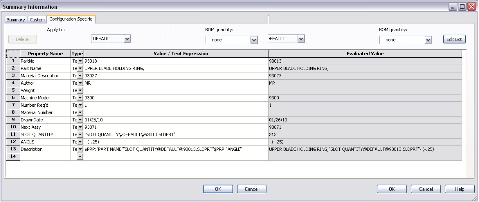

Attached is a pic of my file properties.  The "Description" is the one I am having issues with.
How do I make the Evaluated Value of "Slot Quantity" show up in the description?
I have tried these two:
\\\$PRP:"PARTNAME""SLOT QUANTITY@DEFAULT@93013.SLDPRT"\\\$PRP:"ANGLE"
\\\$PRP:"PARTNAME"\\\$PRP:"SLOT QUANTITY"\\\$PRP:"ANGLE"

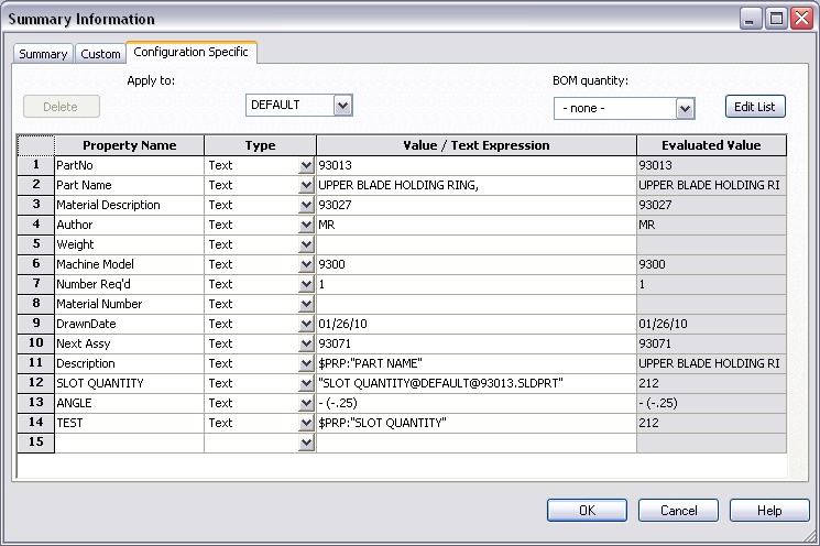

JB 2010-01-29 Best Answer
Have you tried naming your property something different from the driving dimension?
MR
MR 2010-01-29
I think I followed what you recommended.

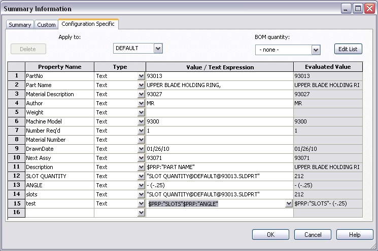

I created a property "TEST".  If all I linked it to was the "slot quantity" then it worked fine.  As soon as I tried to string two properties together it did not work.  See attached.

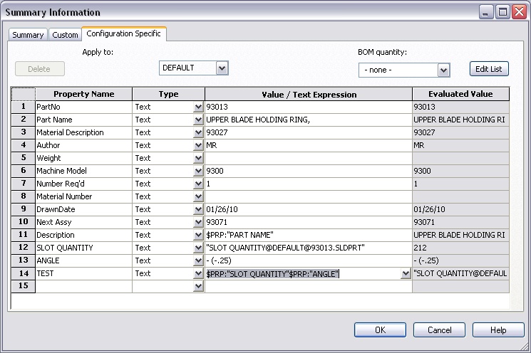

I reread what you were asking me to do...see pic4  It still does not work

DL
DL 2010-01-29
I'd make a design table and assign property values there. You then have all the Excel tools to concatenate text and a whole lot more.
MR
MR 2010-01-29
I had thought of that, but thought it was silly to have to create a DT for this.  I might as well just type in what I want...
DL
DL 2010-01-29
We use design tables regularly, so I don't find them to be any additional effort. Include one in your part and assembly templates and they are no effort at all.
For my way of working, the property window is okay if I need to just type in what I want. If I need equations and spreadsheet functionality such as combining two properties to make a third property, then the design table works well.
