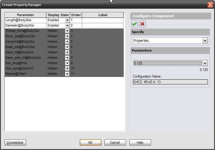

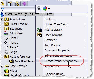

I recently created a Configuration Manager or Property Manager for a component. It works excellent, except that the component is a Smart component with Auto Size in use. The problem is that when I insert this component, it autosizes, but then when it goes to the Configuration Manager the size is reverted back to the default where I have to select it again.
I've got two questions:
  1. Is there a workaround?
  2. Why is it this way? (I'm asking SolidWorks primarily)
    1. Can this be fixed
    2. We've got 2 good functionalities that are of similar application, it seems counterproductive for them not to work together.
