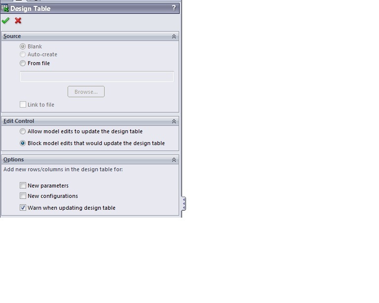

when editing a design table dimension value by changing the dimension value (rather than editing the cell in the design table) SW will change the value of that dimension to be the same for some or all configurations. This does not always happen and its behavior seems erratic.
i probably do not need to tell you but this issue is extremely concering as the only way to ensure model configurations are accurate is to walk thru each one and back check the values. but before you do, make sure you "block model edits" on the design table properties. and only change the values in the design table itself.
my VAR (who btw was very responsive and is sending this issue up the flagpole) tells me this issue SPR 283413 will be fixed in 2010 SP1.
