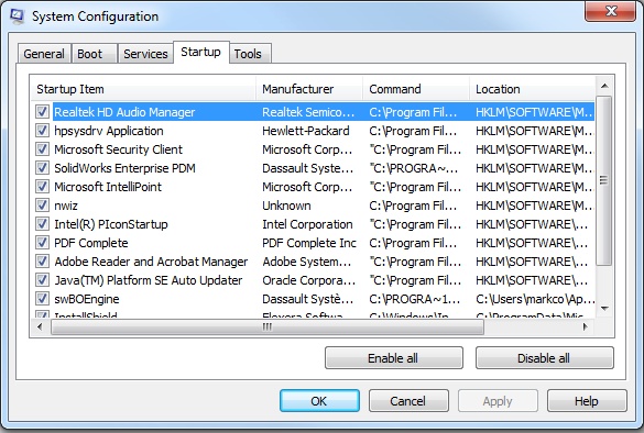

JM
JM 2013-12-05
Nice writeup Anna (as usual ), this is just the type of in depth knowledge that makes me nervous when someone else wants to spec out our Workstations for us that has no idea what is going on with SolidWorks or CAD in general.  I'm sure there are numerous folks out there with horror stories.
Too Mark,
Check into uninstalling the HP Advisor, we've had a number of issues with HP Advisor taking control of video card updates and really causing issues.  Not a fan of the Advisor.
MC
MC 2013-12-05
John,
I don't think I have HP Advisor on this machine. See attached system configuration - whats at the bottom is InstallShield and solidworks background downloader (which is off). Should the advisor be in this list if I had it?
SF
