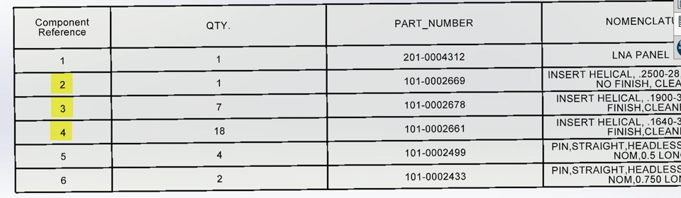

I have created a simple assembly.  I have assigned a number to the "Component Reference".  I intend to use this value for Item Bubble Annotations
Note that the "Yellow" items (I added the yellow) are SolidWorks Assemblies.

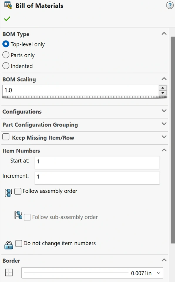

Here is how I configured the BOM Table.

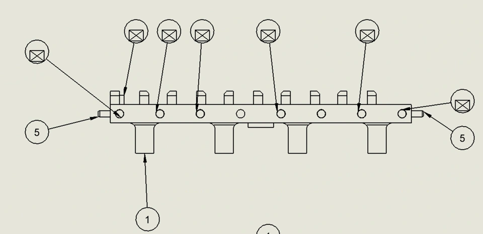

This is an image of a drawing after I attempted to use "Auto Balloon" annotations leveraging the "Component Reference" Values
Note that all of the Values with an "Envelope", represent an instance of one of the Assemblies in the Main Assembly.
Is there a setting that I have not found.

You mentioned Envelope.  You do realize that Envelope items are excluded from the drawing BOM?  This means any Balloon attached to an Envelope item will be empty.
DM
DM 2025-04-23
you can add a row to the bom for your references instead of having to add parts.
there are options in the bom to show envelope in the bom I think
