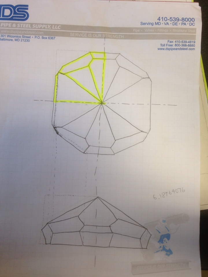

COMPLEX GEOMETRY SHAPE
I am trying to create this shape as best as i can 3d in solidworks and am having a dificult time. i have about 5 years experiance using solidworks and have done some difficult things. Does anyone have sugestions on best way to go about this. i have tried making a block and extrude cuting sections out and also trying to make verious plains but the farther i get into it the worse it looks.

I'm sure my way would not be the best way, but here is what I would try.
1) sketch the 12 sided shape seen in plan view
2) extrude that to the max height
3) sketch the profile on the right plane
4) extrude that through all
5) sketch the profile on the front plane
6) extrude that through all
7) create a new planes perpendicular to the angled facets shown in you plan view
8) sketch the profile on those planes
6) extrude those through all
I'm not sure that would work, a lot of stuff in SW doesn't work the way I think it should, but that's how I would try it.  Good luck to you.

Hi Dustin,
I would be tempted to use a 3D sketch to define the faces of the prism.
With some judicious use of planes and relations, you should be able to get something which is geometrically correct and stable.
As Glen has noted below, it appears that you have two lines of symmetry. (It looks likes you're already working on modelling a 1/4 at a time, based on your highlighting)
I've attached my sloppy practice part, which is neither geometrically correct OR stable...
I've assumed that all the faces are planar (though you will notice this isn't true of my model)
Feel free to have a look at it to get a feel for what I'm driving at, though it needs a fair amount more work.
I would say that I'm not sure whether this is the best way to approach this, but just my take on your challenge.

Dustin,
I don't have time to tackle it right now, though it looks interesting.  One thing I thought I would mention if you haven't already thought of it.  It looks like it has two lines of symmetry, so you might want to look at modeling 1/4 of it first, then mirroring twice.

Depends on what geometry information you have.
If you know all the facet point positions, you could create a 3D sketch.
If you know the various cross sections & a few key dimensions (base profile, apex height, etc), you could create a set of 2D sketches on angled planes, connect the dots, create a set of surfaces, & finally knit them together to create a solid.
If you know only the facet angles & a few key dimensions you could create a set of planes and use the Intersect function to create a solid.
What ever method suits best, Glenn's suggestion to apply symmetry and create only one quarter and then mirror is good.

Thank you i actually went about it this way and yes i did it in quarters and mirrored it twice.
I think the main problem working off of this customers sketch was that all the plains needed to be flat and in this sketch the gemetry was wrong in places and impossible to join at all the locations while keeping a flat surface plain on some of the geometry so i changed it around a little.

are the top left/right and bottom left/right corners suppose to be symmetrical or offset like drawn on the paper? as in they are thicker towards the middle and thinner on the ouside.

Raul,
You can brake this shape down to 4 parts the highlighted corner (top left) and the one across (bottom right) are identical corners and the other two are a mirror immage of these corrners.
I have sucesfully created this in solidworks
i found that the 6 sided part in the far corners does not work the way it is and have a flat surface i changed it slightly to fix that

make each face seperately and position them using the move body command
