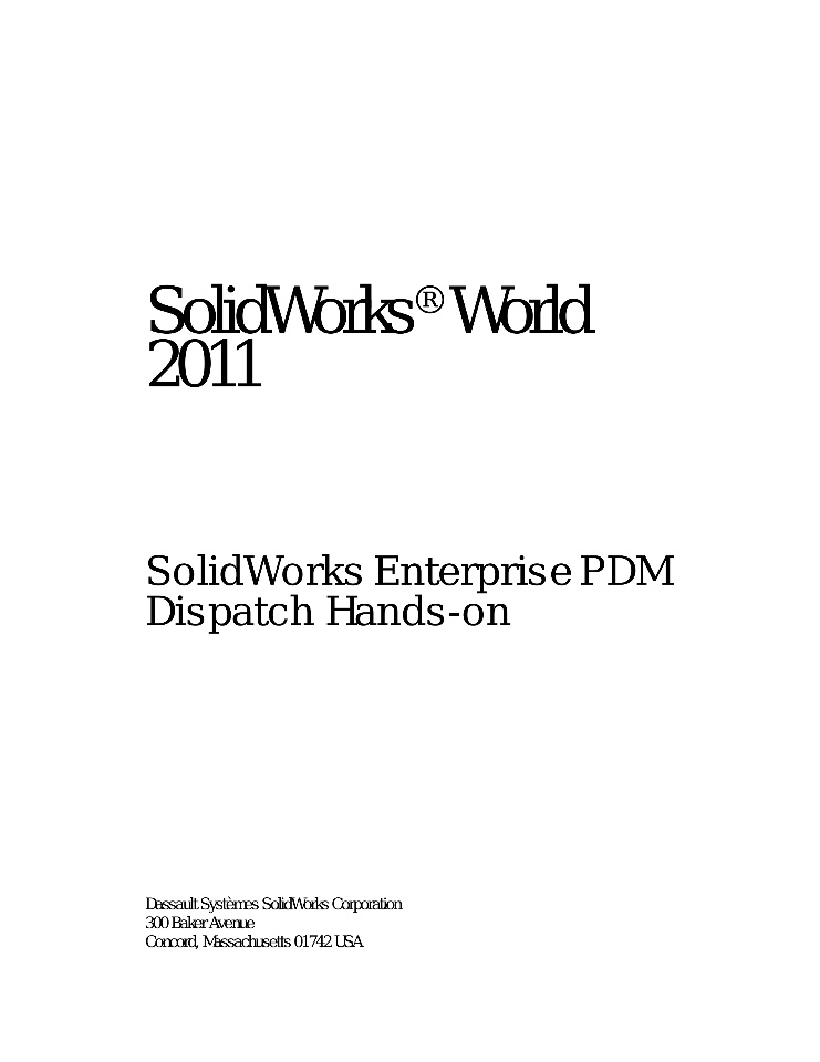

You can use Dispatch to compare two variables on a state change.
Arie
BD
BD 2014-04-10
Hmmm.... I was worried it might come to that. Unfortunately, although I'm familiar with SW VBA, I am fairly new to EPDM and have never used dispatch.
AG
AG 2014-04-10
This will get you started...
BD
BD 2014-04-10
Sweet... THANKS!
