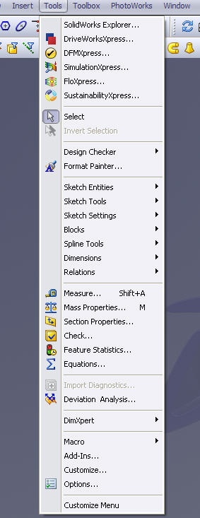

I've got a SW2010 professional license.  In 2009, when I wanted to do a geometry compare between two part, it was under the toolbox menu.  Now it isn't there.  I looked at the help file and see that it "should" be under the TOOLS/COMPARE menu now?  The trouble is when I look under TOOLS, I don't have a COMPARE heading to go to next.

I just checked my system and under the tools/compare there is a flyout which includes drawings/features/geometry. Is that what you need?

That's what I need, except I don't have a TOOLS/COMPARE.  I've posted a screenshot of my tools menu.  I looked under the customize to see if maybe it was turned off, but it isn't there.  I also have all the add-ins turned on.

If you have a document open, you may need to customize the tools menu to show the compare menu.  Go to Tools > Customize Menu (at the bottom) and check the box for Compare if it is unchecked.

Can you add the compare documents command to the evaluate tab of your command manager?  It should be under flyout toolbars.

you are comparing a part correct?
go to tools> addins and select "solidworks utilities"
then go to utilities> compare geometry

I don't seem to have an add-in for Solidworks Utilities.  Utilities should have been loaded during the installation correct?  Maybe I just need to do a reinstall.  Since I've already upgraded to SP2, can I use the install disk to load just utilities or would it be better to completely uninstall 2010 and start fresh?

You should be able to install Utilities without reinstalling anything else. Use Control Panel / Add/remove programs. After selecting SWorks, you should have a checkbox for either changing or repairing. Select that and eventually you will get a check box for different items in SWorks. Select Utilites to be added and it should install after that.

That was it.  When I went into the repair menu, the solidworks utilities was checked as being installed.  So I unchecked it, uninstalled utilities and then rebooted.  I did another repair/modify and reinstalled utilities and it shows up in the add-ins section.
I now have the compare menu under tools.  Thanks for all the help.
