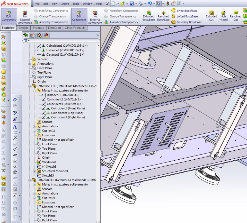

Hello,
from some times I notice some duplicate icons in the Command manager area when on edit parts...
Is there a workaroud to solve the bug?
thank you.
Gianni

Hi Gianni,
To add or remove any unwanted icons from any menu, RMB in an empty space of the menu bar and select 'Customize'. You can then drag icons onto, or off the menu.
thank you Bjorn.
I did it sometimes ago... but today this trick wasn't in my mind..
(I never added the duplicate icons so it is a mystery for me how it was possible..)
ciao
No problem Gianni,
Solidworks does mysterious things sometimes. I recommend getting everything the way you like it the using the copy settings wizard (one of the tools installed with solidworks) to make a copy of your settings. Then when things go a bit crazy you can simply restore your settings. I do a new copy every few months to capture any tweaks that may have occurred.
