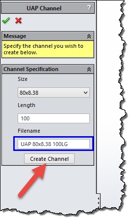

I got this macro from Luke Malpass and he did a good job in creating a "design library" like interface for this macro. Thanks to Luke.
When I run this macro in 2015, It works fine except it doesn't create the part with proper file name when "create channel" is clicked
Please see the screen shot and the attached files

It's working till I enter all values (size and length)
I modified the file location in the class1 module to point to the .sldprt location
When I click the command button "create channel" it does nothing
See this screen shot with the part
comment imagecomment image

I have both these file files in a folder
Please open the class1 module and modify the line to point to the part location (this is my location)
<p>Const masterName As String = "I:\SOLIDWORKS Data (2015)\Design-Library\UAP.sldprt"</p>
You may have to modify the FileDialogs  module to add PtrSafe if you are running on 64bit machine
Hope it works now
Thanks
JOHN

Could not find anything wrong yet. Were you able to run this macro in older versions of SW?
JG
JG 2015-01-25
I tried the macro in SW2014 and getting the same result
When I click the "create channel", nothing happens
I think it should allow the user to save the file with file name specified.
Are you able to save with the proper file name when the "button" clicked?

Got it working after by passing "GetSaveFile" -function and replacing "." (dots) with "," (comma) in the data fields. Added also:
Const saveFolder As String = "C:\Structural Members\"

Found a better solution from here:
32bit API Open/Save dialog function fail - Microsoft Community
Now it should work the same way as with 32 bit.
