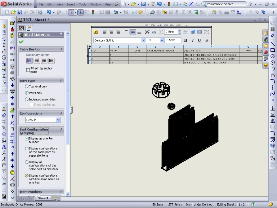

I have a part with multiple configurations because ofdifferent lengths. See attached. I have gotten it as far as gettingthe length of the part to show up in the qty by using a designtable, but I would like a way to combine the qty's. I can't usepart configurations grouping because of the way we do ourfasteners. (one file multiple configs for the sizes, so I can'tcombine these.) Since I use the document name to show as a partnumber...the bom shows each part as a different line but it has thesame part number. Our fasteners show the config names so the partnumbers are different. Is there a way to combine these or a wholedifferent way to go about this?

It's really not all that hard. There are three options forpart configuration grouping in the SW BOM property manager. I thinkyou are currently using "Show different configurations separately"or something like that. As you said, this won't let you groupthings, even if they have the same name. Similarly, you can't use"Show different configurations as a single line item" or somethingto that effect. What you can use is the third option - "Showconfigurations with the same name as one item". Then, in your part,you have to set each configuration's "Name to use in BOM" on theconfiguration properties to the same user-specified name. It has tobe a user-specified name (not config name or document name), or thecombining won't work. This should get the different configurationsto combine into a single line on the BOM.
Not knowing exactly what flavor of funny you used to make lengthshow up as qty, I can't guess as to whether the qty for yourcombined line item will equal the sum of the lengths of all theinstances.

I went in and switched the properties to a user specified valueinstead of document name. That didn't change anything. Maybe thereis a different way to show the length in the qty. I tried to linkthe "Length" value directly to the d1@sketch1 value, but SW can'tlink that with different configs. The way I have done it is in thedesign table there is a dimension value for each config, I createda "Length" property that is what shows in the bom. Then in thedesign table I just made the cells equal.
I have attached an example of what I am doing. The nuts need to beseprate. The wire duct needs to be combined.
Any help is greatly appreciated.

Seems to work on my end.... Are your "part configurationgrouping" options the same as mine? Here's a screen shot:

HAHA. It works. When I tested this yesterday, my coworker andI had a miscommunication. I changed one file and she testedanother. It works. Thanks a million.
