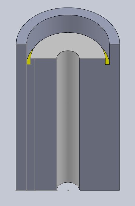

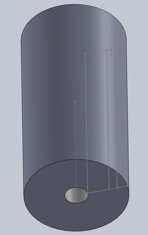

I'm using 3 revolved boss/base components to make up 3 concentric cylinders, and wanted to color each cylinder differently, but seem to be having some trouble doing this. As an example, I wanted to color the outer cylinder grey, the middle cylinder yellow and the inner cylinder pale grey. As can be seen, from the top it looks like my coloring worked. However, if we look at the bottom of the part, it has taken the color of the outer cylinder, ignoring the color selection of the 2 inner cylinders. Furthermore, when doing a cutaway we also see that the 2 inner cylinders have the same color as the outer cylinder. Is there a way to solve this problem? Any help would be greatly appreciated.

You have merged/combined all 3 cylinders so the bottom face becomes one surface. Being one surface it can only be one colour.
Options
1. Don't combine/merge bosses.
2. Use split line to create splits in the bottom surface. Then apply colour to face.
3. Apply a decal to the bottom surface giving the illusion of different colours.

Thanks for the advice Richard, I'm hoping to apply the color all the way through each of the solid cylinders from top to bottom, not just on the top and bottom face. Would I need to create 3 separate sketches and then revolve around each sketch instead of making 1 sketch and having 3 revolved bosses around 3 different areas of that single sketch?

You should also be able to split the bodies and color each.

Nevermind, I re-read Richard's original post and saw the "don't combine/merge bosses part". Worked like a charm, thanks!
