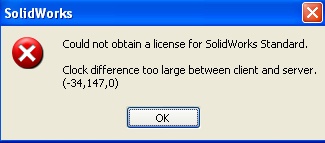

Clock difference too large between client and server?
See attached.
A user can't open Solidworks. 4 licenses free. He could earlier andnow can't. He has no other Solidworks instances running. He hasrebooted. Can anyone help us out. Much appreciated.

AW
AW 2009-07-08
The message means what it says. The clock on the server andthe clock on the user computers are to far apart. Sync up theservers and clients with a time server and you should be fine.

"Sync up the servers and clients with a time server and you shouldbe fine."
How do I do this? I don't have access to the server for reboots oranything so I'd have to explain to our IT dept how to do this.

SF
SF 2009-07-08
Derek, it depends what type of network you are connected to,how your servers are set up and what OS you're running as to howyou go about syncing time. We're on a domain here with one serverand the workstations are set to sync time with the server when theyare booted. Ideally the server should sync with an atomic clock,ours tends to be off several minutes.
SF
SF 2009-07-10
As a VAR (Value Added Reseller), we've hit this problem a fewtimes on our internal network when trying things out for customers.
For those who want to free themselves from their IT department, thecommand you have to enter in the DOS command prompt is:
Net Time \\computer name /SET
You enter this on the computer you want to change to match the timeof "computer name" in the command. (Typically you type this in onthe client, and use your server as the computer name.)
The spaces between net time, and the name, and /SET are important.
If you get a System Error 5 while doing the command, check yourtime zones, months, years. The times must already be somewhat close(within a handful of minutes) for this command to match themexactly.

DT 2009-07-15
Thanks to all who replied. We haven't seen the problem again. Freak thing? Everything has been running smooth.
