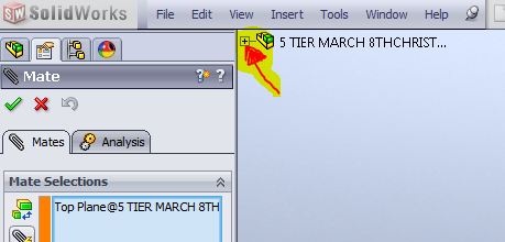

Before I put this in as a bug to Solidworks I thought I would see if any of you guys are getting this problem. When clicking on the plus in the attached it quite often takes quite a few attempts before the tree expands.

No, never seen that, in 2009, 2010 or 2011.

I don’t have the “plus” selection problem but I no sometime have to select twice on items in the tree.  I have noticed that the point of the arrow is not where it would seem to need to be to pick the plus.  If I recall correctly, it needs to be off to the right or left of where it “should” be.

I am not having that issue at all and I am using 2010 SP 4.0
The only thing I can tell you is I find is easier to access this tree
if there is not any geometry in the background of where I am selecting.

Steve - I get this all the time!  Thought it was down to my eyes/mouse/graphics card/monitor/whatever.  If only you & I see it, maybe we both need a trip to the optician...
I'll pay attention to this over the next few days and try to understand where I'm going wrong

I also have seen it and I think maybe it kind of goes along with the need to click on things more than once before it takes.  It seems that SW gets tied up in some kind of loop and will not recognize any clicking until it comes out.  Then it will accept the clicks.  A reboot usually makes it work better for a while, but I am hoping that SP3 will have something in it that helps.

Sounds like some of us are getting it and some are not. One thing I know is that 2 of us here get the same problem and that in 2010 it did not occur.
Sounds like a bug to me and one that could do with squashing.
Fingers crossed for SP3.0.

1)     The mouse pointer becomes out of synch with the mouse sensitive area; this applies to everything you select.  The workaround, until reboot, is to consciously offset the pointer when you click.  A different computer might help.
2)     The input queue is blocked until a previous operation is finished.  A faster computer might help.

I also get this problem (SW2010 SP3.0). I think from memory if you click on the feature manager design tree tab it will also expand the same area that you are trying to expand with the +.
I also agree with the other comments regarding having a clear graphics area behind where you are trying to click on.

I always make sure that there is nothing behind the tree before clicking the cross. It seems to me that it is simply a bug that needs fixing. I've been using solidworks since 2006 and it only starting happening since 2011.
Time to put in another request for it to be fixed. Its not a showstopper of a bug but its annoying.

I got this all the time, sometime, I have to double click it, maybe a overkill, but hell what I can do. It is a bug to me, but I am OK with it because I have a working solution - click it several times lol.

What Bruce said is correct. You can click the title area of the Property Manager tab to expand/collapse the graphics view feature tree. Just click where it says "Boss-Extrude" or "Mate" or whatever function you are using. It's a much larger target than the plus sign.

I have the exact same problem.
Using 2011 SP3.0
Never had this problem before I started using 2011.
Really frustrating when I need to open up the tree while mating items in an assembly and I have to click it several times.

Had this problem in SW2010, exact same scenario..several clicks to activate the drop down...yet to experience it in 2011 although i havent really been using it all that much since upgrading.

I've submitted it as as a bug to solidworks. The more of us that do that the more chance its got of getting squashed. As I say its no biggy put a PITA non the less.
