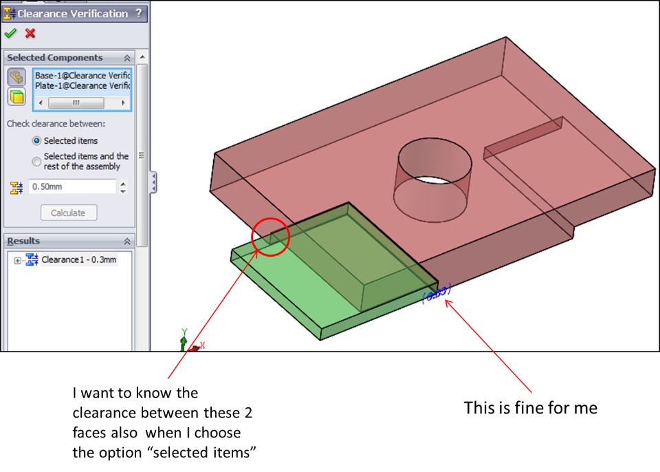

I'm just on the way to explore my knowledge on Solidworks Clearance Verification and I have came across a simple problem.
I have made a simple assembly with 4 parts and I want to check the clearance between 2 parts of it. I selected that particular 2 components and I clicked on Clearance Verification and I have given the clearance value as 0.5 mm. After clicking on Calculate, solidworks shows the clearance between these 2 parts only in one direction. why is that so?
I want to check the clearance between these 2 parts in 2 directions say for example X & Y but solidworks gives me the clearance in only one direction.why?
And also,when I choose 2 parts to check the clearance between, how solidworks identifies between which 2 faces(which axis) I'm expecting the clearance?
Has anyone thought of this?
Pls check the attached picture for more clarity.

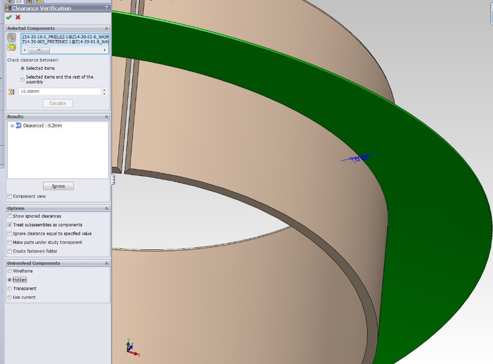

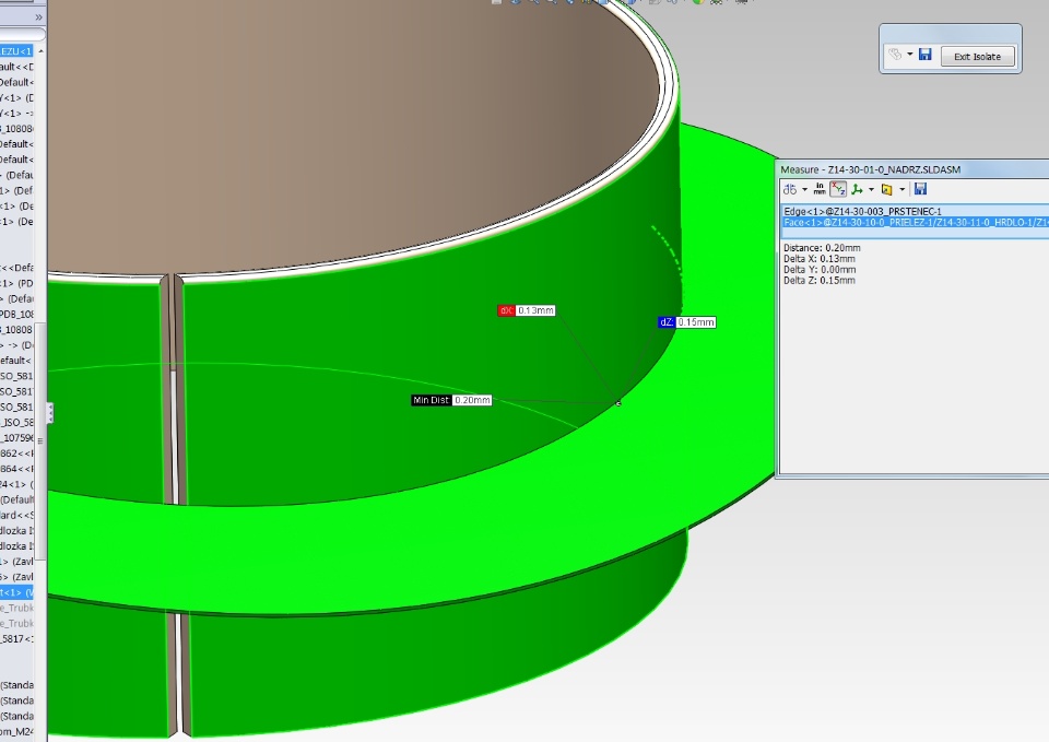

Hi,
Clearance measures the minimum distance between the bodies. Measure measures the distance between the surfaces, vertices, edges - minimum and dx, dy, dz.
