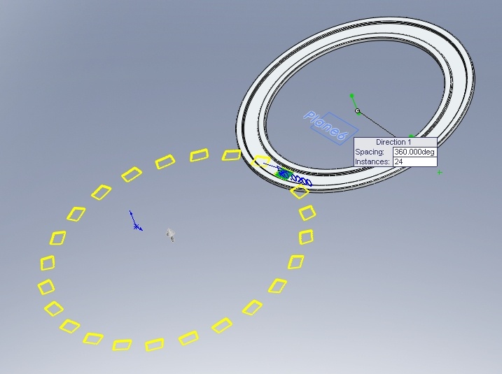

I am trying to do this circular pattern. Attached is thepreview. The features I am trying to pattern are one extruded cutand two fillets. The axis is in the center of the ring. As you cansee the axis that the pattern is getting revolved is totally wrong.

I found the answer. I was using a centerline in a sketch forthe axis. I added a reference geometry entity called an "axis" andused that for the axis. That worked.
