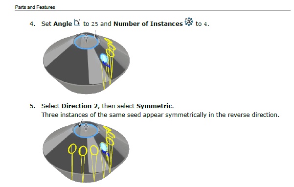

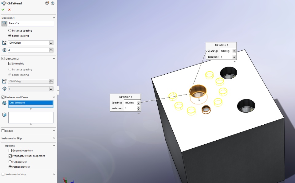

I am not able to control the second direction on the new bi-directional feature of the circular pattern feature. If set to symetrical as below, direction 1 is correct as expected but direction 2 adds an extra hole. If I turn off symetrical & manually input number of holes an extra hole is still added.
The example in the "what's New" pdf shows it working correctly below.

This surely is a bug (not reported I guess) if you select the face/edge/axis. But if you pick the edge or axis to define the direction then it works.

I get the same error if I pick face, edge or axis for direction as you can see below. Looking at your screenshot, you have picked edge for direction & it is still showing the bug. The only difference I noticed from picking face, edge or axis was that the extra hole hole switched from direction 1 to direction 2 or vice versa.

Sorry, must have been in sleep and didn't noticed that extra hole.
Yes it is a bug.
