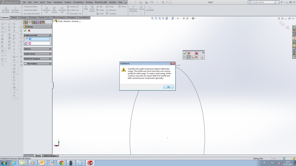

I am trying to draw a simple circular spring via using "swept boss/base" function. I am doing exactly same thing which you can see in below link;
designLOG • Tutorial: Solidworks curved helix [advanced]
if i summarize it first i open a sketch to front plane ,draw a circle and close the sketch , then i pass to right plane open a new sketch a draw a line and close sketch again. When i try to use swept function with try to use straight line as "profile" and circle as a "path" it gives me this error and i can't draw a turning circle spring.Can you help me what i am doing wrong?
Best Regards
Answers 2
JS
JS 2015-05-07 Best Answer
You should be making a swept surface, not a swept solid.
Insert...Surface...Sweep
Jim S.
IM
IM 2015-05-07
Like Jim Said,
Here is a attached file for you.
