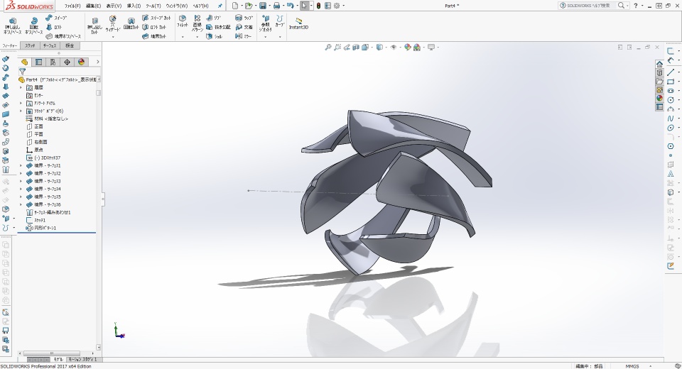

Hi Everyone
I usually use Japanese, so please allow my mistakes in words.
So, this time is first contact
Sample program( a part of all)
Private Sub Rorat (Nz, Nd)
Dim Part As Object
Dim boolstatus As Boolean
Dim swSketchManager As Object
Dim myFeature As Object
Dim skSegment As Object
Dim swModelDocExt As Object
Dim swFeatureManager As Object
Dim SelMgr As Object
Set Part = swApp.ActiveDoc
Set swSketchManager = swModel.SketchManager
'Select right Plane
swModel.ActivateSelectedFeature
swModel.ClearSelection2 True
swSketchManager.InsertSketch True
swModel.SketchManager.InsertSketch True
boolstatus = Part.Extension.SelectByID2 ("Right Plane", "PLANE", 0, 0, 0, True, 0, Nothing, 0)
Part.SketchManager.InsertSketch True
Part.ClearSelection2 True
'Line depiction of rotation center
Set skSegment = Part.SketchManager.CreateCenterLine (0.2, 0, 0, - 0.2, 0, 0)
'Selection of body for circular pattern, selection of axis
boolstatus = Part.Extension.SelectByID 2 ("Knit Surface 1", "SOLIDBODY", 0, 0, 0, False, 256, Nothing, 0)
boolstatus = Part.Extension.SelectByID 2 ("Line 1@Sketch 1", "EXTSKETCHSEGMENT", 0, 0, 0, True, 1, Nothing, 1)
'Circular pattern
Set myFeature = Part.FeatureManager.FeatureCircularPattern5 (Nz, 2 * 3.14159265358979, True, "NULL", False, True, False, False, False, False, 1, 0, "NULL", False)
End Sub
