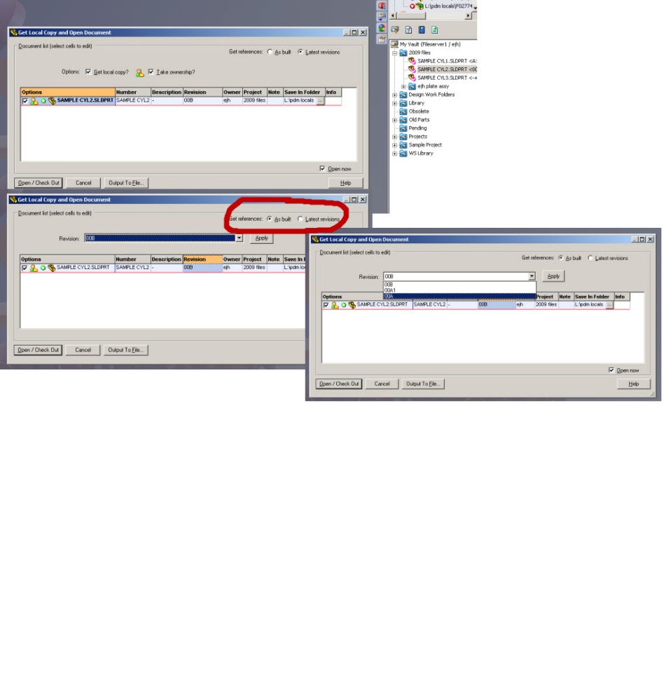

I should have a simple question (I think), but how do you check out past revs from Workgroup PDM 2009? I'm coming from Inventor Vault that was very easy so I think I'm just overlooking something???

Thanks! I was missing the clicking on the revision column. I would click on the bullet as you did but I couldn't go any farther.
Thanks again.
