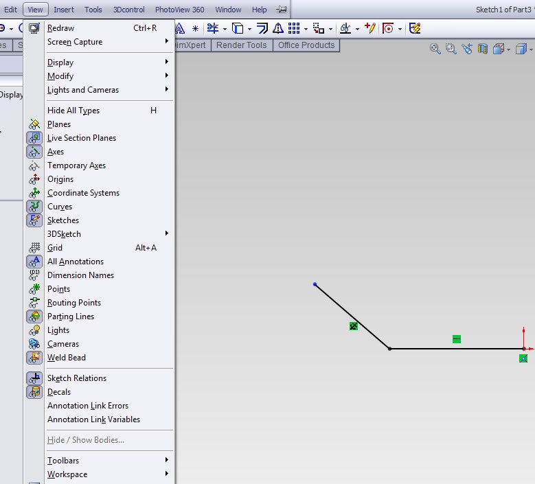

I have a requirement that all sketches be fully defined but it doesn't help if people use the Fix relation to do that so I want to check all models before they're released. How can I check all models in a folder to see if the Fix relation was used in any of the sketches. I looked at the SolidWorks Design Checker but it seemed so limited on what it could actually look for. Any ideas? Thanks.

JH 2011-12-06 Best Answer
One way is to go to the view/hide tab and turn on view sketch relations. Then you can look for the "anchor" sign. It's not very elegant or quick, but it sort of works.

SF 2011-12-06
I want to try to avoid opening up every sketch or even the model if possible.
