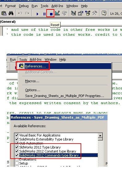

When i run this macro there is an error message, how to resolve?
DG
DG2013-05-26
Hi Denny,
You may need to fix the missing libraries in the macro.
To fix libraries, open the macro (Tools > Macro > Edit). Go to references, uncheck the three highlighted libraries in the picture or missing libraries and select same for your version of SolidWorks. Save the macro and run again.
Hi Denny,
