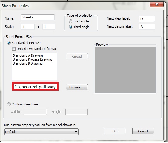

Hey guys, this is a question of sheet format pathways.  There should be an option somewhere that changes where the input field in the attached picture points/references.  Does anyone know where it is?
I have all my .drwdot files lined up in a place I want them, but I work a lot with multisheet drawings - that means I need my .slddrt templates set up as well.  I repurposed my sheets from a coworker (whose folder I do not have write access to) so they have both types of sheet formats in my folder at work, where I have write access.  All the discussions and help topics just say to change the file locations in the "System Options" tab, which I have already done.  It's annoying to close out a dialog box saying that I do not have write access to somewhere when I feel I have already went through the trouble of changing the sheet pathway.  I've also completely reset the "File Locations" area and realigned the formats - no dice.  I could tell the "you do not have read access" notification box to not display the message anymore - but that's just treating the symptom, not the disease, right?
The attached picture shows the box that pops up when you go into System Options>Drawings>"Show sheet format dialog on add new sheet" and add a new sheet on to a drawing.

You might have it checked but make sure Sheet Formats locations are appropriate under Tools > Options > File Locations.
Also if drawing was done using a sheet format/template that was located on a different location earlier, then SolidWorks will show that path only which might be a reason that you're getting a wrong path.  To simply fix this in the add sheet dialog box, click on the required sheet format and hit reload.

I've mentioned that I've inspected the file location options, and besides the location of my custom sheet formats, there are no file pathways listed in the "Sheet Formats" drop down box, or the "Document Templates" drop down box.
In the box that has the sheet formats listed in my attached picture, you'll notice that my custom formats are listed ("Brandon's A Drawing", etc), none of which exists in the location that the red-boxed field is indicating.  This is mystifying.
I tried hitting "Reload", but upon selecting a sheet format in the box the button becomes grayed out.

Try doing a browse and see where the path leads you to else select one of the sheet format and that would become your drawing format.

Open your drawing template and look at the sheet properties.  The location you have highlighted in you image is probably pointing at your co-worker's location.  Change it and re-save the template.  Note that SW will NOT apply your changes if the file name for the new sheet format is the same as the old, even if it is in a different folder.  You have to either name the file something else, or change the location to some other file and click ok, and then change it to the one you actually want.
So, if you have a sheet format C:\Brandon\a.slddrt and the drawing template sheet properties point at C:\Coworker\a.slddrt, you must change your template to some other sheet format such as C:\Brandon\b.slddrt, click OK and then change it again, pointing it at C:\Brandon\a.slddrt .

Eureka!  Making a new template did it!  This saves a sizable chunk of hassle.  Thank you, Jim.
