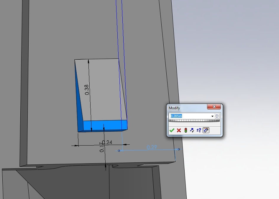

I have a model that I want to see three significant digits when editing the dimensions.  So I changed the units to .123 under options.  However when I double click on a feature to see and edit the dimensions driving that feature, they still show up as .12.  When I click on the dimension and the edit box opens, it shows in .123.   This is forcing me to double click on each dimension to check the value.   Is there still something that need to changed?

remember even if you change the primary your number that was typed in will still be the driving number. so if i type in .375 and the primary is set to one place that shows .4 on the drawing or part or assembly, when i double click and the change box comes up it will still show .375!!!!!!!!!! if you need a number only 2 place you need to type a 2 place so you would type .38 instead of .375, primary is for display only, you will make a mess if you think otherwise and things won't fit together because of either rounding up or down when the actual dims is what you typed in.
