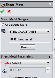

Good evening,
Can someone help me how to change sheet metal parameters steel gauge via API. Part I have is using predefined gauge table with 15 different materials.
I assume I`ll have to use the following code with some other code to change the gauge? Right?
boolstatus = Part.Extension.SelectByID2("Sheet-Metal", "BODYFEATURE", 0, 0, 0, False, 0, Nothing, 0)
Any information or link to a similar topic will be great.

You need to get the pointer to sheet metal feature. You can do this via selection or just directly by name: PartDoc::FeatureByName. This will give you a pointer to IFeature object where you can call the Feature::GetDefinition method. Now just call the following method to set the gauge table parameters: SheetMetalFeatureData::SetUseGaugeTable.
Take a look at this example demonstrating the usage of gauge table: http://help.solidworks.com/2013/English/api/sldworksapi/create_base-flange_feature_using_gauge_table_example_vb.htm

Sorry Artem, I`ve got myself confused.. Don`t really have a lot of experience with API and its structure.
So I have a sheet metal part with "Sheet-Metal" feature and Gauge table attached.
    Dim swApp As SldWorks.SldWorks
    Dim swModel As SldWorks.ModelDoc2
    swModel = swApp.ActiveDoc
    Dim ShMetalFeat As SldWorks.SheetMetalFeatureData
    ShMetalFeat.SetUseGaugeTable(True, "c:\Program Files\SolidWorks Corp\SolidWorks\lang\english\Sheet Metal Gauge Tables\Steel Gauge Table.xls")
   What should I do next to change thickness from 7gauge to 10 gauge? Typically it has to be done manually by choosing Gauge from the drop down menu in Sheet metal Parameters (see 1st post picture).
Thank you.

Here is the sample which changes the gauge thickness to the last value in the drop-down. You need to select the base flange which is uses gauge table and run the macro:
<p>Dim swApp As SldWorks.SldWorks</p><p>Dim swModel As SldWorks.ModelDoc2</p><p>Dim swSelMgr As SldWorks.SelectionMgr </p><p></p><p>Sub main() </p><p></p><p>    Set swApp = Application.SldWorks </p><p></p><p>    Set swModel = swApp.ActiveDoc</p><p>    </p><p>    Set swSelMgr = swModel.SelectionManager</p><p>    </p><p>    Dim swFeat As SldWorks.Feature</p><p>    </p><p>    Set swFeat = swSelMgr.GetSelectedObject6(1, -1)</p><p>    </p><p>    Dim swBaseFlangeFeatData As SldWorks.BaseFlangeFeatureData</p><p>    </p><p>    Set swBaseFlangeFeatData = swFeat.GetDefinition</p><p>    </p><p>    Debug.Print swBaseFlangeFeatData.UseGaugeTable</p><p>    Debug.Print swBaseFlangeFeatData.GaugeTablePath</p><p>    Debug.Print swBaseFlangeFeatData.ThicknessTableName</p><p>    </p><p>    Dim vThicknesses As Variant</p><p>    vThicknesses = swBaseFlangeFeatData.GetTableThicknesses()</p><p>    swBaseFlangeFeatData.ThicknessTableName = vThicknesses(UBound(vThicknesses))</p><p></p><p></p><p>    swFeat.ModifyDefinition swBaseFlangeFeatData, swModel, Nothing</p><p>    </p><p>End Sub</p>
