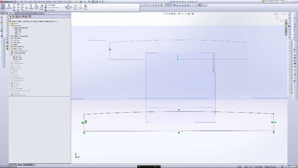

I've got a design table driven model and recently got a few requests that would fundamentally change the relationships on which one of the sketches is based. Namely, in my current model, I have to lines with the relationship of "equal" to a couple lines in another sketch and then an arc who's radius is "driven". The request would be to change the radius of the arc to be the driving dimention and the line length would be driven.
If you look at the attached screen shot, the larger sketch is the one I'd like to change.  The two vertical lines have the length dimension equal to the vertical lines in the smaller sketch in the back ground.  The arc dimension is driven.
I know that this would be easy to implement by making the changes and saving as a new model but I'd really like to be able to keep it in one model and be able to change those relationships through the design table if at all possible.

Let me try to explain another way.  I basically want the model to be able to be built one of two ways.
Case 1: vertical lines drive the radius dimension - this is what I have right now.  Changing the radius in the "far" sketch changes the line height in the "close" sketch which drives the radius in the close sketch
Case 2: Radius in the close sketch is driving the line height in the close sketch or, no interdependent relationships between the two sketches.
Ideally I'd be able to configure the relationships via the design table.  Exactly what I'd like to do is
Case 1:  As is
Case 2:
Suppress the equal relationship between the line in the "far" sketch and the near sketch
Change the dimension of the "near" radius from driven to driving
Specify the radius of the "near" radius.
I'm just not sure if it's possible to do so with a design table.

Sketch relationships can be supressed individually for each configuration.  You will end up with a "$STATE@Tangent23@Sketch1" column in your design table (or whatever relations you are working with).  Then you specify "S" or "U" values to suppress or unsupress within each configuration row in the design table.  This can also be controlled from the sketch directly if you double click the relationship to edit it there.  The bottom of the Display/Delete Relationships control box has a Configurations dropdown window.
I was also able to suppress a dimension that appears in column C of my design table to make it driven by adding a "$State@Distance21@Sketch1" column (see my screen capture).  This was initiated by selecting the dimension while editing the sketch, clicking on the "other" tab and the "Specify Configs..." button below the "Driven" check box.
So, in my first 8 configurations, a dimension is Driving based on the value in the design table column C while my tangent relations are suppressed.  And in the next 3 configurations, the dimension is Driven (so the value in column C is ignored) and the unsupressed tangent relations fully define the sketch.
