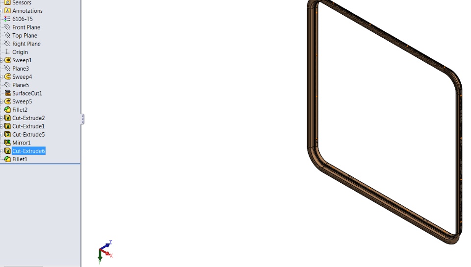

Hi Guys,
Hope had a nice day so far.
I have a part which shown below and would like to change it SheetMetal part which can be flat to Know the length of the part.
Any idea or Suggestion?
Cheers,
Sam
Hi Guys,
Cheers,
Sam
Check the swept flange option in sheet metal.
Tnx mate,
How can I check swept flange option in SheetMetal ?
Cheers?
I meant to say that you can use the swept flange option in sheet metal tool to create a similar part. You may also try using convert to sheet metal to try converting the part in sheet metal but it would be better to redraw the part using the swept flange option.
Here is one video: https://www.youtube.com/watch?v=Vep_cyFv9rg
The process is similar to using sweep tool.
