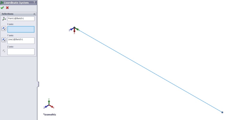

Hi,
need help on creating a macro to create a Coordinate System on a sketch point and align its Y-Axis to a line in XZ-plane (turning Y-axis to 90 degrees).
(below pic shows my requirment)
in the below code, the CS point is created but alignment is not done. I am not sure how to use "Set swFeat = swFeatMgr.CreateCoordinateSystem(skPoint, sx, sy, sz)"

    boolstatus = Part.Extension.SelectByID2("Point1@Sketch1", "EXTSKETCHPOINT", 0, 0, 0, False, 0, Nothing, 0)
    Dim skPoint As SketchPoint
    Set skPoint = swSelMgr.GetSelectedObject6(1, -1)
    boolstatus = Part.Extension.SelectByID2("Line1@Sketch1", "EXTSKETCHSEGMENT", 0, 0, 0, False, 1, Nothing, 0)
    Set sy = swSelMgr.GetSelectedObject6(2, -1)
