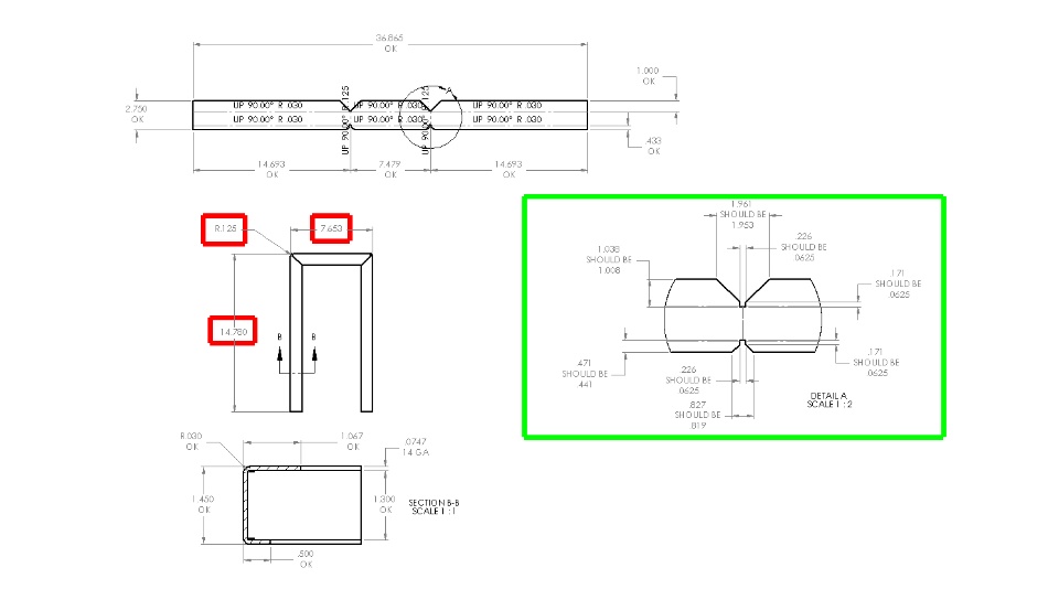

I am using SW2010 and trying to make a sheet metal starting from the flat I already have.
In the jpeg I have attached, you can see the flat (14 GA = 0.0747” thick x 2.75” x 36.865”) and the final section: these cannot change.
My boss wants to use a K factor of 0.250001473 (not 0.25 …. too easy), so I made it how you can see in the top view, which is close enough to real part.
My problem is the notch. SW gives me dimensions bigger than what we do (see detail A): the top number is what I get from SW and the bottom number is what we do and what it should be.
Is there any way to change this notch without changing the flat and the final section?
I can give up a little the overall dimensions in the top view, but I need the dimensions of the notch.
I tried to change the radius .125” in the top view to a smaller value so the notch gets smaller, but I don’t get close to what I need.
Any suggestion??
I have attached the jpeg + the SW part + the SW drawing.

You're going to have to create a second configuration of the flat and modify the notches.
If you make things to tight the flanges will slam into each when folding the last bend(s).
IMHO, if you're welding those corners, a .009" gap on .075" steel is not a big deal.

A little work around for what you want;
One thing you can do is insert the un-fold command and when the part is in the flat position add a sketch to close up the gap, extrude to the metal thickness and insert the fold command.

Done, but it tells me it can't unfold after it.
KB
KB 2011-09-29
i added a config. i only modified one set of notches.
you might need to adjust some of the dims a little more.
see attached

Basicly these are the steps:
1) flat it
2) add the material with extrusion
3) fold it again
Am I right ??
I see what you did and it works, but ......
Why do you have to add a configuration to do this??
Maybe I got it: you are tricking it!!!!
You left the bent as it was, added material in the flat but you never use this when it's bent: right ??
KB
KB 2011-09-29
right.
if i tried to bend with extra material a collision occurs and errors will show up in SolidWorks Feature Manager.
I see you already found out about this in a response below.
You must use this manually created configuration in your drawing.
Do not use the flat-pattern that is automatically generated by SolidWorks.

The reason is the part bends back into itself, more then likely you can only go a little bit. (SW detects that issue)
There has been a few times that I would have added the sketch/extrude in the flat pattern only and left the 3D model go.
Add a configuration like Kenneth said above, change only the flat pattern and leave the rest go.

I tryed myself, and I was able to trick it without adding a configuration:
I added the extrusion in the flat pattern, which will be suppressed in the bent position.
How is this possible now???
KB
KB 2011-09-29
oh, i forgot you could do that.
the extrude will always be suppressed in the folded state because it is "after" the flat-pattern feature.
you happy now?
ZF
ZF 2011-09-29
Yes. Thanks.
The conclusion is:
you can't change the parameter of the notch, but you can trick the flat as you want.
Or .... is there a way to change the parameter of the notch ????
