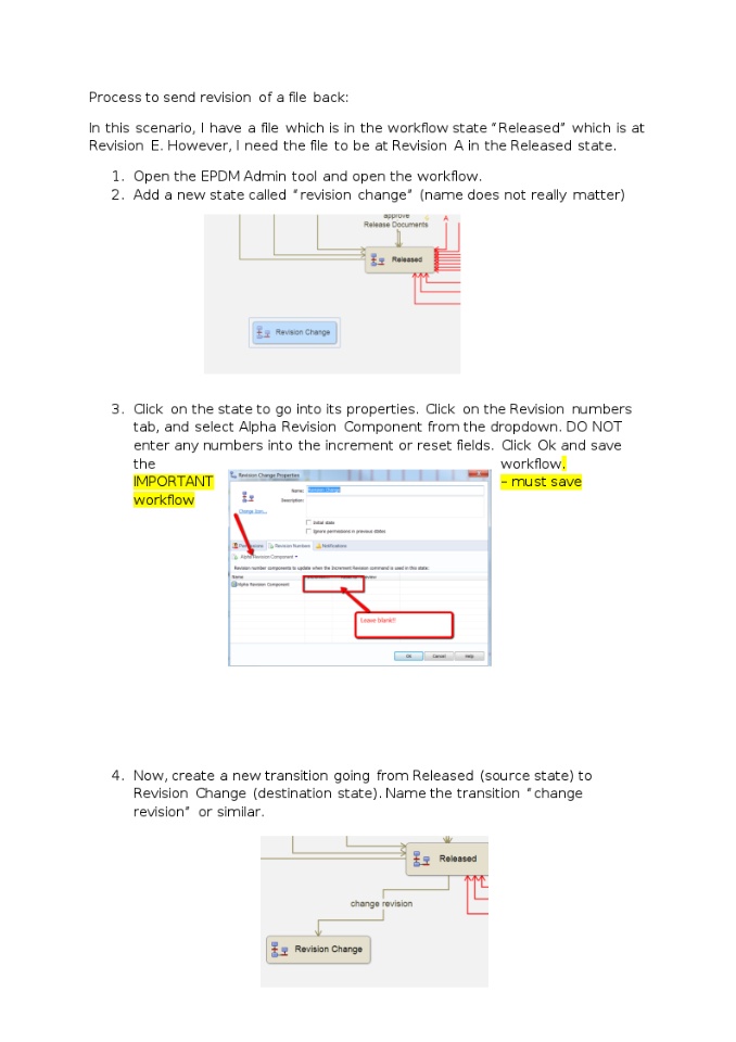

SF
SF 2016-03-15
Hi you can also use the reset and increment revision actions in a EPDM workflow to reset your revision.
See the attached word document for more details.
Thanks
Prasad
