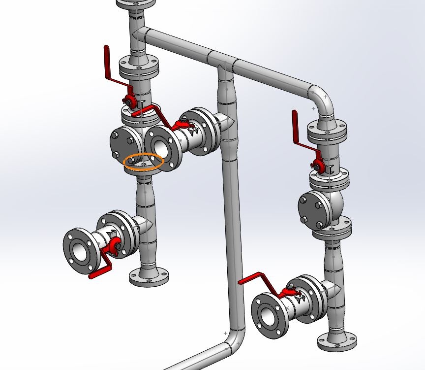

I have managed to change fittings material from Carbon steel to SS except pipe. Can anyone tell me how to change pipe route property in one shot.?

As far as I know you can't do it in one shot.
The only way I know is by means of Route Segment Properties.
  • Edit route
  • highlight a segment
  • right mouse click
  • from the pop up menu select Route Segment Properties
  • In the left hand pane you'll now be able to change the pipe, be it config or even selecting different pipe template, as well as what the standard Elbow should be
  • after making the chances click the green check mark and leave the editing mode
  • now you'll have altered that one segment to the new size/PN/SDR/schedule or material
This does mean that you'll have to do that for each and every pipe segment.

Thanks Peter....perhaps, only option left is to change every bit of pipe segments.
