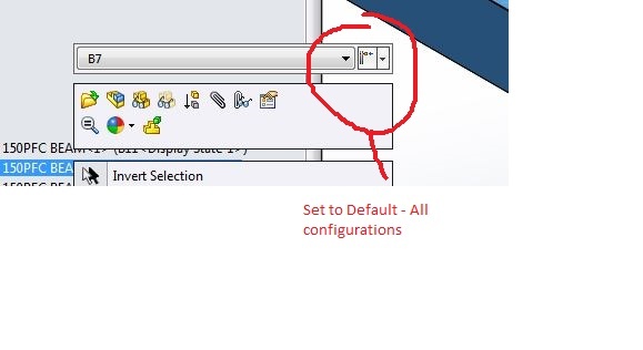

Is there away to set the to configurations of a component in an assembly to default change for all assembly configurations, rather than having to change the drop down option every time. it is driving me mad. See image below. SW2014

Many ways:
1. Use Configure component, but that might take a lot of clicks depending on how many configuration the assembly has
2. Just pre-select all instances of the same component (use the filter if they are all over the tree) and use the Component Properties to set up the configuration of those components in bulk in all configurations of the assembly.

same request here, there are three possibilities and I am looking for a way to set one of them as a default. (for me that would be "all configurations"). When you change it in an assembly, the next time you try the same action it will still come back with "this configuration" so it is not stored inside the assembly. Can't find it in the registry either so where can this be set or manipulated?
