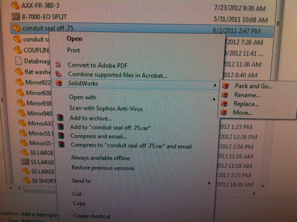

JP
JP 2012-10-29
Hi Kent,
just in case you want to rename the files, open a windows explorer to locate them and select one, right click and select solidworks and then rename,
remember that you need to rename both files part and drawing (OR assembly and dwg) of every single part number.
hope this helps.
SF
SF 2012-10-29
Thank you gentle.  Finally figured that out by your solution-File Explorer.  But will see you soon with more questions ☺.
