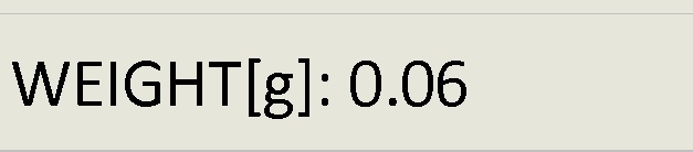

I want to increase the accuracy of mass in drawing by increasing number of decimals to 4.
As you can see its 0.06 now, but I'd like it to have 0.06XX. Drawing note contains of a Custom Property connected to Weight Property of model.

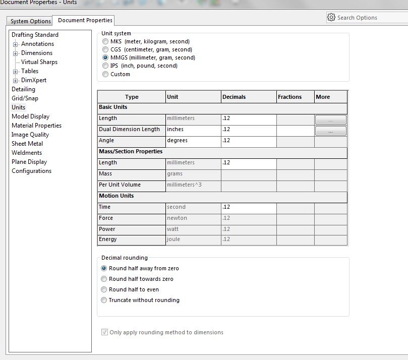

I can't change settings in options:
What to do?

DB 2015-11-26 Best Answer
You are on the right track....
comment imagecomment imagecomment imagecomment image
SF
SF 2015-11-26
Thanks, for pointing out which line is it actually. It worked.
