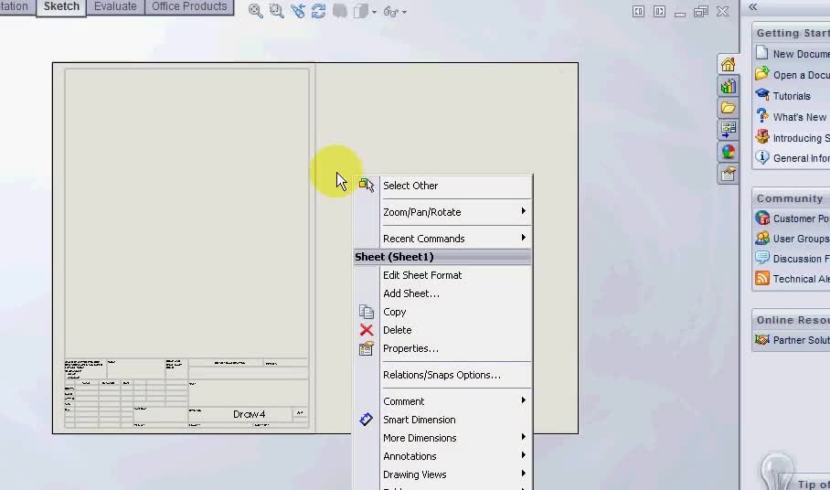

Save A4 as A3. Now edit the saved A3 sheet format. Right click on it and change the paper size, relocate the title block and border lines. Save again.

You've to save a copy of A4 as A3 and edit that. Doing this, everything will be available to edit in saved A3 file.

The problem is that if you have A4 with custom property of block and text, if you change the size from A4 to A3 (change the paper size) all type of custom text will Disappear.

Check if this helps.

I have two workstation, one if I do what's you did in your video, all lines and texts will disappear, for the other workstation it's ok.

Because the sheet format must be empty or make sure "display sheet format is checked" when you right click on sheet and select properties.
SB
SB 2012-11-20
Thank you very much.
I resolved the problem.
