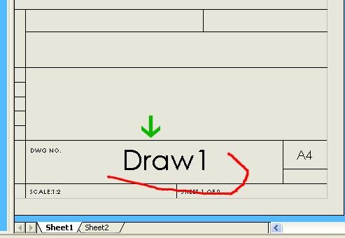

Change existing text notes in two Sheet
There are tow sheet in Drawing
Need change Note
Example1 "Draw1" Change  "DrawSheet1" in Sheet1
Example2 "Draw1" Change  "DrawSheet2" in Sheet2
Sheet1 ---- obtain ID No:DetailItem13 *** Text: Draw1
Sheet2 ---- obtain ID No:DetailItem13 *** Text: Draw1
Obtain ID NO Program
