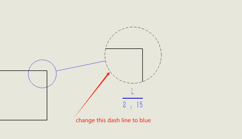

In 2024, I still curious how to change the detail view board/outline color. Actuall I searched the entire forum thoroughly, but I couldn't find the answer I wanted. Thanks

There are many settings available at Tools > Options > Document Properties > Views > Detail Views. Setting up the appropriate border line type and color in a Layer, and then assigning Detail Views to use that Layer, should take care of it.
Thank you so much.
