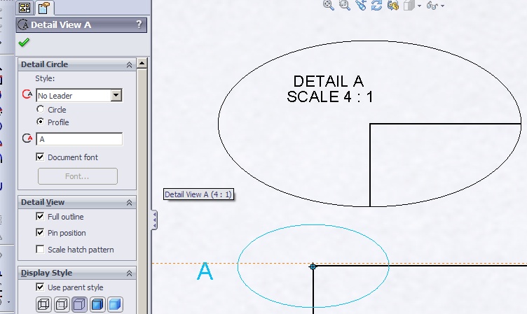

I don't believe you can change the default setting. The border is controlled in "options"/"document properties"/"view labels"/"detail". There you can change the line type, etc - but circle is the only default choice.

If you need, you can change the profile but can't set that to default.

aahhh...I figured out the profile selection option is only available in the ISO standard, not ANSI.
Maybe a good suggestion for the next sw.?

Huh, profile IS available in ANSI settings.

why the "profie" option in my computer greyed out?

To use that option, a closed sketch is required. I'm assuming you've got that already, so maybe it's a bug?

Has no one had this issue since 2009?? (Mine is grayed out as well) I'm on SW 2011. I was able to select the profile while in ISO, but as soon as I switched back to ANSI it changed into a circle.

You need to select a style other than Per Standard or Broken Circle.

I don't understand why that works...but it worked!! Thank you!

Per Standard means use the shape as specified in whatever standard is being used ... which is normally a circle.
Broken Circle means just that ... a broken circle.
