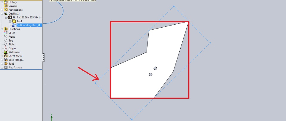

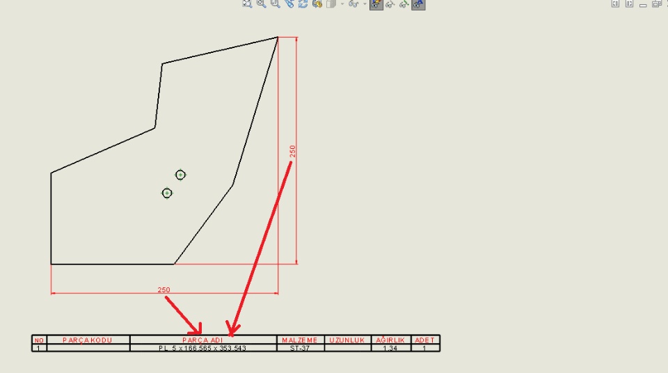

This has to be written as customized macro and don't think it can be offered for free as this would need a good amount of time.
MC
MC2015-05-04
Have a look at this thread. I have one that should work or at least be really close to what you are looking for. You will see the source in one of my posts.

Have you trying to rotate your sketch or the UCS to make your part in the right axis?
