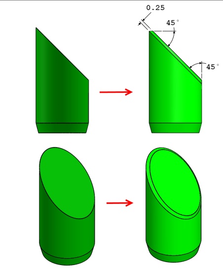

I have to create similar model with mild steel for a project here. Never came across any tutorials online, so thought of asking in the sw forum.

Another way, use surface extrude with draft. It'll create the chamfer in 1-step.

Thanks Paul, it looks like your approach is so easy after I see your solution. Thanks for your help.

I started with using the split lines, then used a surface loft to project a cone like structure on top of the part, then used surface cut. But in the end, the result was not good.

That's well cool I never realised how to do that,,
but its nuts, if you reverse the direction (without draft) you get a hybrid surface/solid - ZTG?!
Maybe good for making optical illusions

Something that I noticed too while playing around, then discarded it as " something weird".
with draft we get these 2 features (in single body) connected by edge that is not possible with normal extrude / cut.
..the easiest way is the extrude or cut .25" from the plane at 45 degs.
Hi Paul,
From where do I need to create the 45 Deg plane ? can you explain a bit more ?
