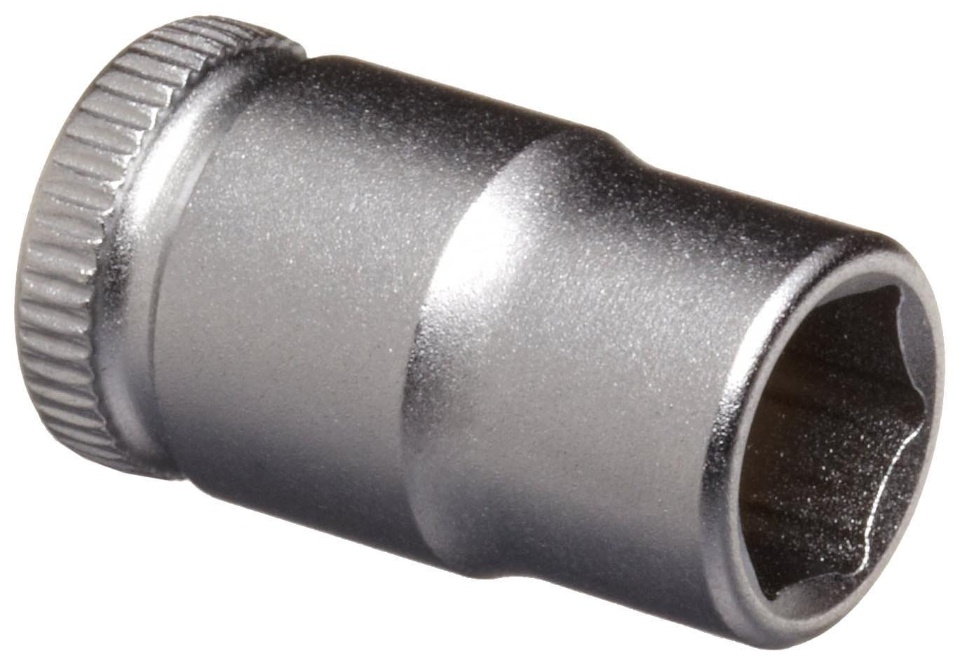

How can I make chamfer around the hexagon?
It have to looks like this:

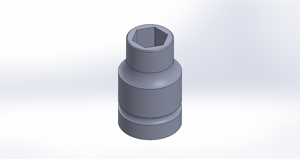

My part:

Revolve cut a triangle around the axis of the socket.
LB
LB 2013-12-10
<p>Ian Worrall wrote:</p><p></p><p>Revolve cut a triangle around the axis of the socket.</p>
even easier cut a circle using the draft at 45 degrees
