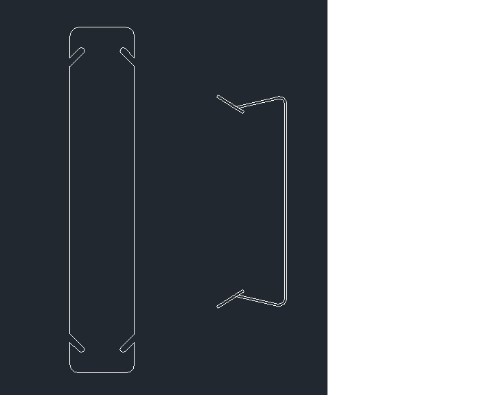

Challenge: How to solve this "partial bending" ???
Please, have a look to the pic attached. You will see inmediatly the challenge.
Thanks. I don't know how to solve.

You can use a Sketced Bend to perform that function.
EP
EP 2013-09-20
Bernie, that works well.  Tried it myself.  The highlighted bend is only drawn on half the bend as I made this part as a quarter, and then mirrored it twice to get the whole part.
If the second sketched bend goes too far into the radius of the slot, it bends and rolls the hook over, instead of letting it stick out as if it was formed with a narrow tool.
I forgot what the trick is to prevent that?  Otherwise you could make the bends, and then add the "hook" material as a tab.

here is a model (2012) that you can look at.

I looked at your part, looks and works great. I'm more of a fan of modeling the part using Bend Flanges though with this one I might have used the side profile alone leaving out the two top barbed bends. The insert the slots, Mirror them and then insert a Sketched bend on each flange. Neither way is right or wrong, it's just how each person 'styles' their modeling. I come from more than 40 years of sheet metal experience so I could layout this part, verify the bend allowances, program, set up the turret and bend this part too.
SF
SF 2013-09-20
You have to end the Sketched line in the slot or bend relief, if it travels over the 'tab' even a little it will bend it.

more than that, the bent portion of the part can't extend past the slot - in the model I posted, if you change that bend to 90 degrees, it will bend the barbs as well.

That's because of the bend tangency, it connects/interferes (etc) past the relief. Changing the bend radius to .060 prevents that.

The extrange thing to me is that it works or it doesn't work, just depending on the bending radious !!!
Radious 1,6 more ore less, it does not work, because it does not let it to stick out.
Radius 1 mm, then suddenly works !!!
I got it, but.... any technical explanation for that?
